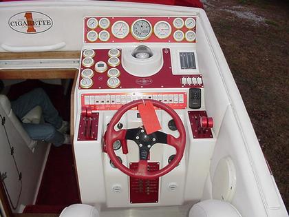

The Top Gun has a different cap than the 38 Hawk/flat deck. The 38 Hawk/flat deck had a much sharper angle to the fairing. The Gun has a different dash and cabin and is much more sleek than it's predecessor.
Here's the old dash.
