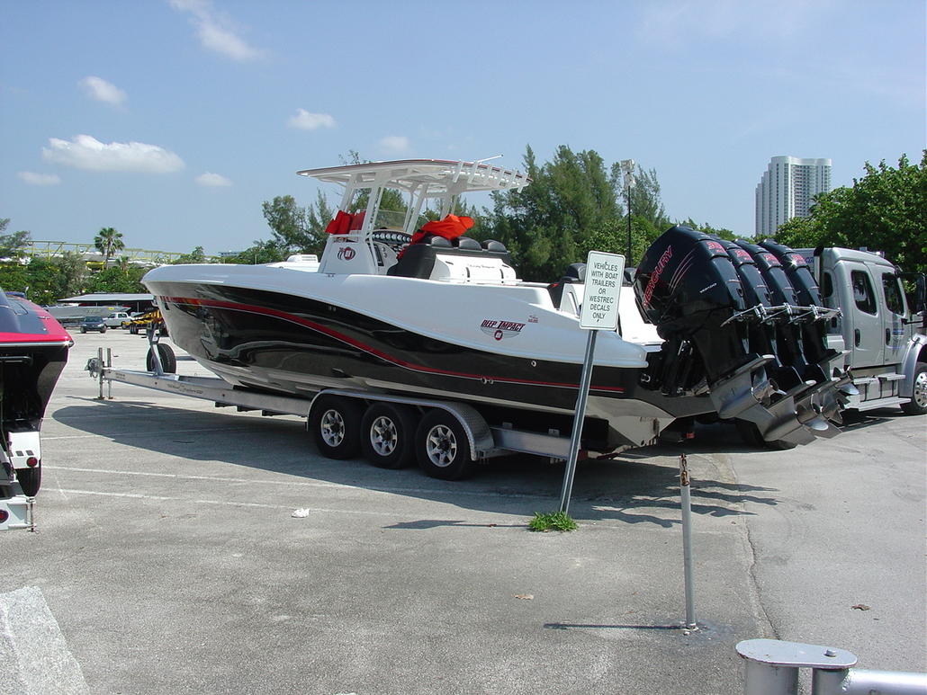

Alex Palma from Deep Impact and I ran the Bimini Ocean race in the Black Quad 36 with 350 Verado engines. We were full of fuel with 420 gallons, full of water 55 gallons, and were able to average over 74 mph. The boat weighs about 15,500 loaded like it was and we burned 46 gallons per motor with a total of 121 miles running.
We have seen 85 and change on this boat before and we have 15 people in it during our owners tournament the week before and still hit 83.
We actually ran over between 65-71 and back 75-81. We still hit guardian mode five times despite holding the motors in to keep water pressure up and to limit the "zinging" of the outside motors. All in all a great time.
