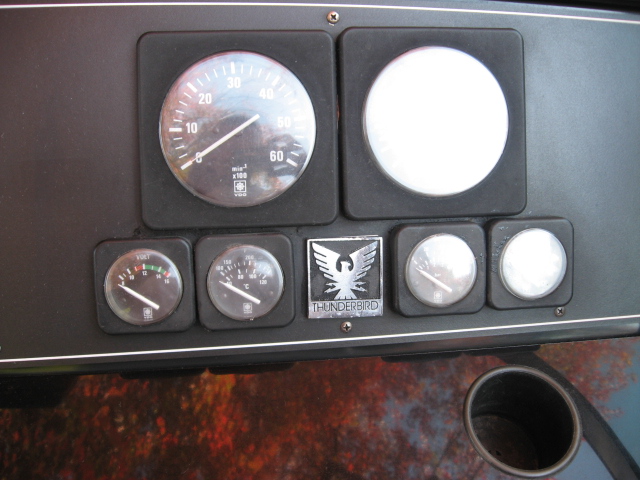

The square bezel comes off with a counterclockwise twist. If anyone needs one after Treads gets rid of his,I have a brand new one in stock also.
Thanks Magicfloat
The guages on the 34PC mount flush with the panel face, no square bezel. I believe they will still work with the bezel style. Is this correct?
