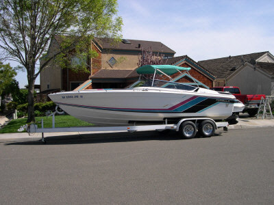

Ya, I know what your saying about the horse power. The original owner lives around the corner, he did all the upgrades to the boat. He saw me getting towed in the other day and wants to get together. I should be able to get more precise info on the engine from him. The guy I bought it from (the 2nd owner) drove it around for a couple of years and didn't do any upgrades, so he's probably not the best source of info. I attached a few pictures of the boat. I'm going down to the boat today to have a look at what's involved with replacing the impeller. From what I saw the other day, it's not good.
The sun's been killing us down here in FLa ....I was considering a Bimini ... Until I saw that pic !!!! ...boy it kills the looks ....but I know its effective .... About "learning" about cranking the motor on the hose .....you saying that now you wont at all ? I need to flush my motors ...and have learned as long as you have plenty of water and keep it at Idle you should be ok ?

I boat on the northern california delta system. The boat is on a hoist off my back deck. From my dock to fast water is about 20 minutes. When the temp starts getting in the 90's and above, the bimini stops the baking. I know it looks goofy, but it's nice sipping on a cold one in the shade, while I'm idling out to fast water.
