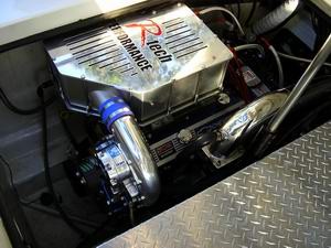

Here's some pictures of the conversion of TOMCAT the boat.
Rtech and Konrad promoted this package to owners of older boats with TRS drives that want to keep their boat, but want power to keep up with the new boats. The Rtech package on a 500 HP engine brings it up to 800 HP. The Konrad package can handle this power easily.
This particular boat, a 1986 Excaliburcat was running 80-81 with 500 HP 502s. After the Konrad installation the boat ran 83-84 because the drives are about 1.5" shorter than TRS. Finding this mph took some prop testing.
After the installation of the supercharger system the boat runs 101-102 after more prop testing. We finally settled on Hydromotive P5X. The Maximus was too much blade and the P5 wouldn't trim out enough.
The conclusion is you can add 20 mph to a heavy boat (8500 lbs) with 300 HP and a drive that can handle it. This should help you run with the new boats for a lot less money than trading in that "old girl" you love so much.
