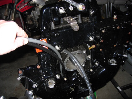

The way it all worked out is this. Near the end of last season, late October, I lunched a motor. It was no big surprise, they where built on the cheap and I was happy they lasted as long as they did. So with the motors out and the winter in front of me I figured it was a good time to address my drive issues.
I started by removing the gimbals and inner transom plates. This is inside with one of the
