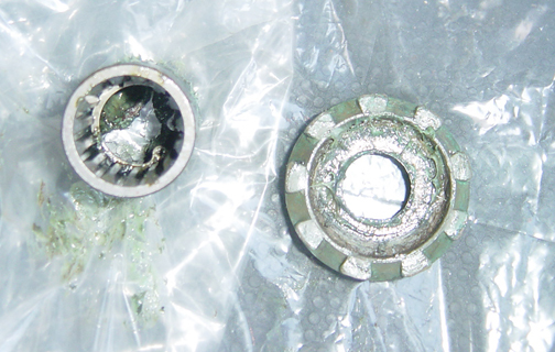

When I went to change my props, I noticed the 3 blade uses different hardware than the 4 blade that was on there.
Here is the 3 blade. I just don't know where this hub goes, and if it is inserted in the front of the prop, is there a specific way it goes in.

Lastly, the thin metallic tab that gets put on before the prop nut, one of the small tabs broke off. Can this be used w/ just 2 of the tabs? even temporarily?

Hey Storm,
Your 3 blade looks to have a pressed in rubber hub and the 4 blade has the newer style insert.
Be sure to use a thrust washer behind either.
Yes you can use the locking devise with a tab missing. It really only requires that you bend one tab to prevent rotation...
