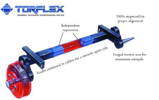

Originally Posted by BajaRunner
Now heres what it looks like normally. What causes this and how do i fix it?
Only known cure is this
![Big Grin](/forums/images/smilies/biggrin.gif)
