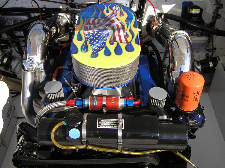

ratman,
The plumbing is fairly simple. The engine is completely sealed. The seapump pumps water through the oil coolers, then thru the heat exchanger, lastly out the headers. The kit from Merc consists of everything you need. The exchanger, hoses, brackets, hardware, thermistat and housing. If you want, I can take a close up picture and post it.
BBB,
My motor is standard deck height, aluminum heads, 540 cu in, 680 h.p. I have a 170* thermistat. It never runs above 180*.
BBB,

I hope these help answer a few questions. If you want some other shots, let me know. The only problem is that the motor is somewhat apart right now. I have the headers, carb belt off for the winter.
