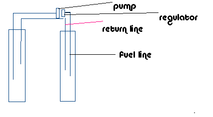

well there are two bungs in the top of each my tanks.both have pick up tubes. one is return one is fuel done in #8 aero. The two feed lines go into a bigfuel filter housing and one #10 comes out and goes to pump,after the pump is the regulator and the returns come out of the bottom of that and go back to the tank. then a #8 feeds the fuel rail for the carb....................let me knoew if i screwed up i am kinda known for that

Here's the problem.
You are drawing fuel off both tanks at the same time?
You are returning fuel most of the time.
You might return more fuel to one tank than it can hold.
In order to make that work, you have to draw off one tank and return to that same tank at a time as there is no way to ensure that they return equally
That means a valve on each supply line and each return line = complicated.
Mechanical pump with valve on each tank or switching valve might be preferred solution.

I thought of that but if there in pick up tubes they should even out .they both will always be pushing against fuel, i dont think there is any other way of total equalization besides this due you.

wobble, i think as long as they are in the pickup tubes it has a constant slight back pressure and should equalize itself, i cant be the first guy to due this. heres a pic
