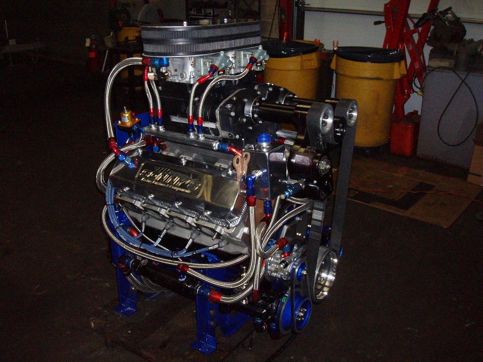

it is typical for most fuel pumps, mechanical, to drop. the only one i have ever used which didnt drop under heavy load is made by C.V Products. the use of a return style regulator mounted after your carb, on the fuel log is essential for proper operation and dependability. the one pictured is from weldon. both pieces are pricey but protect ave save you in the long run.

and for the lines i used here's a pic of the seperator and line from the tank they are -12to sep, -12 from sep to fuel pump, -10 from pump to fuel cooler, -10 from fuel cooler to log, and -6 from log to bowl's. the return is -8. and all fitting s are straight with radiused hose ends which do not diminish inside diameter.
-10 is more than adequate for 800 h.p. . just mount reg as shown, this way if it does jam or fail you ll dump fuel instead of lean out, hich saves form grenadeing.
