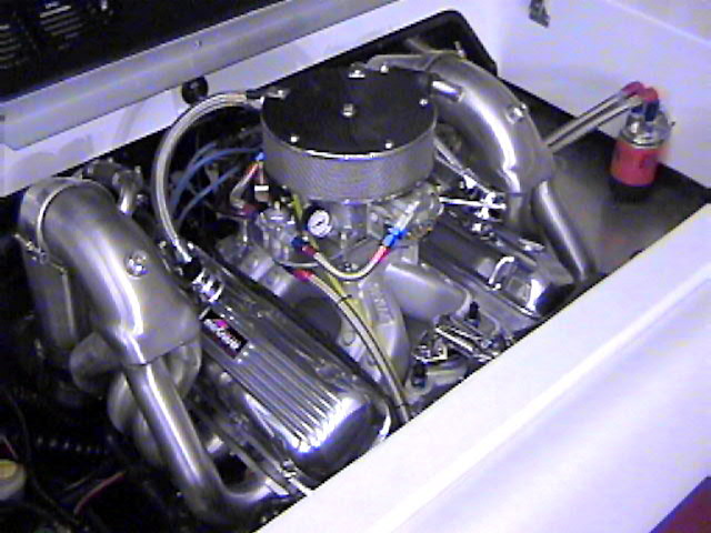

wette vette and advantage 22 ,
Thanks for the info.I will dropping off the block tomarrow.Now i just gotto go get some parts.What ignition systems are you guys runing?
Thanks Dave (p.s W Vette, Engine looks sweet!)

MSD 6M2 box with rev limiter set at 6800. I also run the MSD distributor. It is the only way to go if you plan on running over 5400 RPM. The MSD stuff also makes for a better idle and the ability to alter the timing curve is very nice.
