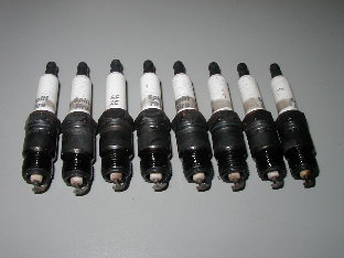

1983 Crusader 350/270 hp Chevys. Split-Fire Plugs in port engine, look great.
Ran Split-Fire plugs in Starboard engine, and fouled them out in 30 hours, and replaced them with Champions, shown.
It would appear the starboard engine is running way too rich.
I have taken apart the starboard carb, see following pictures for clarification.

The rods maked "AV" are the secondary metering rods which are controlled by the large rear air doors.
The others are the primary metering rods. Controlled by vacum.
The jets only control WOT fuel flow, metering rods take care of all part throttle fuel flow. Secondary jets are not removeable.
The parts shown look real dirty. Could use a good cleaning.
As for the over rich condition, the float could be saturated with fuel, debris could stop the inlet needle valve from closing. Either one could cause excess fuel to dump into the mainfold. Maybe a clogged air bleed could do it too.
I'd be looking into a rebuild kit, Merc part number 823436A 1.
