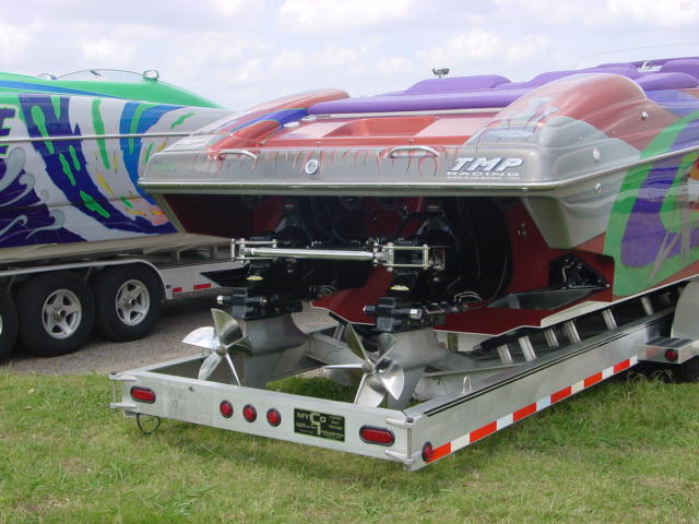

Jeff-Put a couple of 900 to 1000 horse motors in a 43 Nortech and I guarantee they'll put a permanent smile on your face. Only downside is the wind resistance from that ear to ear grin may cost you 1-2 mph! Is that Mayfair steering? With my Mayfair steering, the rams attach to the transom next to the mounting plates for the k-planes. Youve got a beautiful boat/boathouse,etc. Life is good in America! Lou
