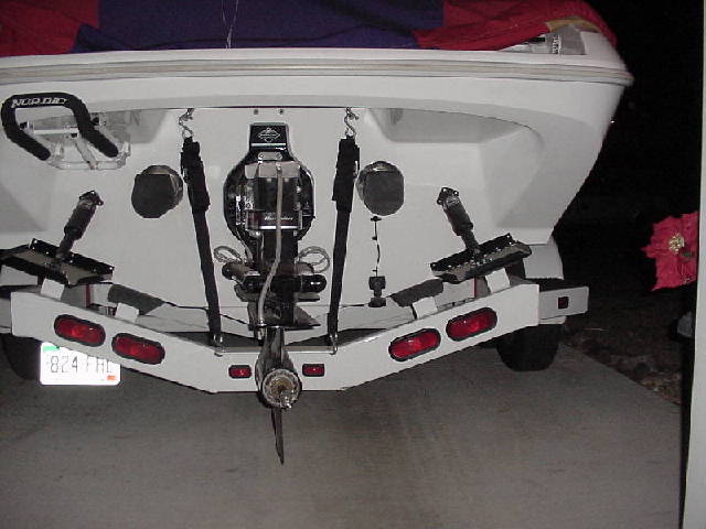

Thanks for the responses. With a little research I found that some Heats came with exhaust located like Indy’s and some like mine closer to the out drive. Also, I had Teague tips put on my boat when I bought her and they stick out 5.5 inches I would guess about 3 inches more than the stock set.
Anyway, I talked to Lonny at Nordic today and looks like WPM will customize what I need. I assume custom means another K……
Indy, thanks for the offer you can see by the pic that mine is set up a little different.

Here's a picture of my Stern, the exhaust ring is only 5.5 inches from the drive.

Yeah...I guess there are some advantages to ordering new from the factory Good luck with the install...post some pics when you are done.
You might want to look into Imco also, I think they do something similar to what you're looking for.
