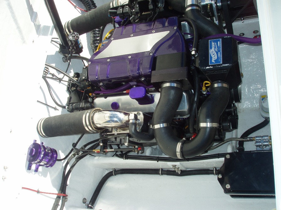

It is very nice to not be tube locked when working on the engine. What's the forward distance in a singe? I pulled my motor so I can't measure. Maybe someone elese can tell us.
I think a tranny takes up at least 8". Here's my old engine, I don't think I would like to take 8" from the front of this set up. It would be too tight.
