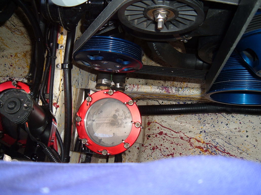

PQ installes them on the "firewall" under each inboard trim pump. Not sure what you need for fittings, other than more hose. Here is a pic on mine on the port side. The strainer is a Gaffrig (Livorsi) and has a anodized red top.

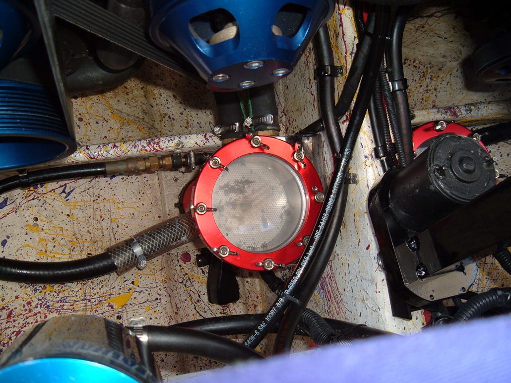

And here is a pic of the starboard side. The strainer is harder to see in this pic.

The bilge pump is further back, you can just see the float switch under the port side strainer.
Apparently the strainers were mounted up on the bulkhead but the previous owner moved them down low to where they are now...I vaguely recall he had some sort of water flow issue.
